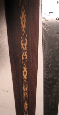

I wanted some custom purfling too so I thought I would try to make some and it's really not that hard. The nice thing about it too is that you can make the purfling out of the other accent woods on the guitar. I am working on a EIR with Mad Rose binding and Satinwood/yellow veneer purfling so I made a backstrip with those same woods.
It takes a little time, but it is really satisfying when those little details all match.
Burton
